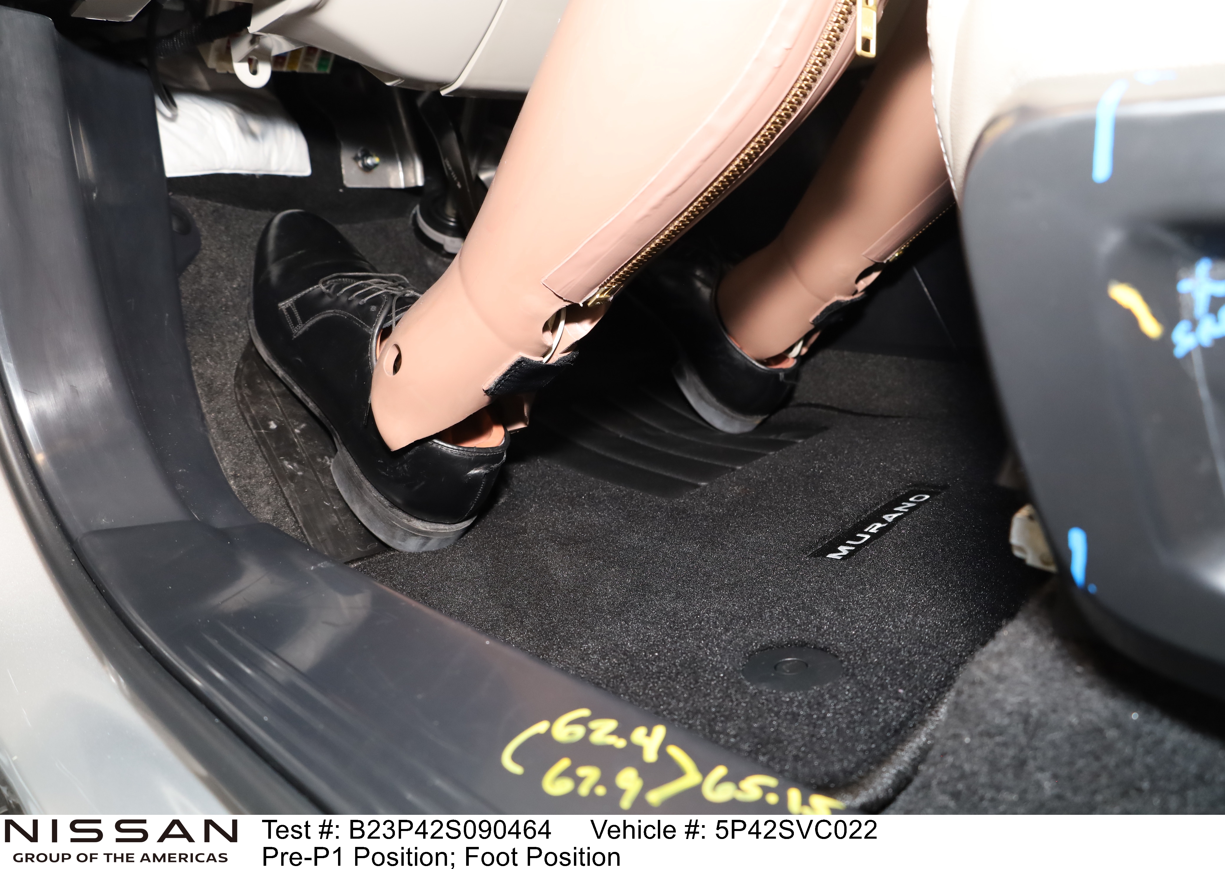

I have made an application for taking photos for Vehicle Crash tests.
It is for Prep/Test Day/Post Test Measurements. Post Test Measurements is still in the works so code generation in process.
The Tool filters the photos required/ Takes the photo with reference picture & Renames/Adds Banner to the Photos with Modified ISO codes and descriptions. The goal of using the iso codes is for future Report Generation/automation.
Some Examples Below, Format: Test#_Category_ISOcode_Description
Attached is an example photo and the Pre-Test and Post Test List
My proposal is that these additional codes/formats be included in some form officially.
Below is a simplified version of the changes
Location 15 & 16 if PH for Photo
Location 13 & 14 is the time phase of the photo.

Required_Photo_List_12_4_2023.xlsx
Crash Pre/Post Test Photo List with full codes
(39.45 KiB) Downloaded 1293 times
Example Photo
Example Photo
