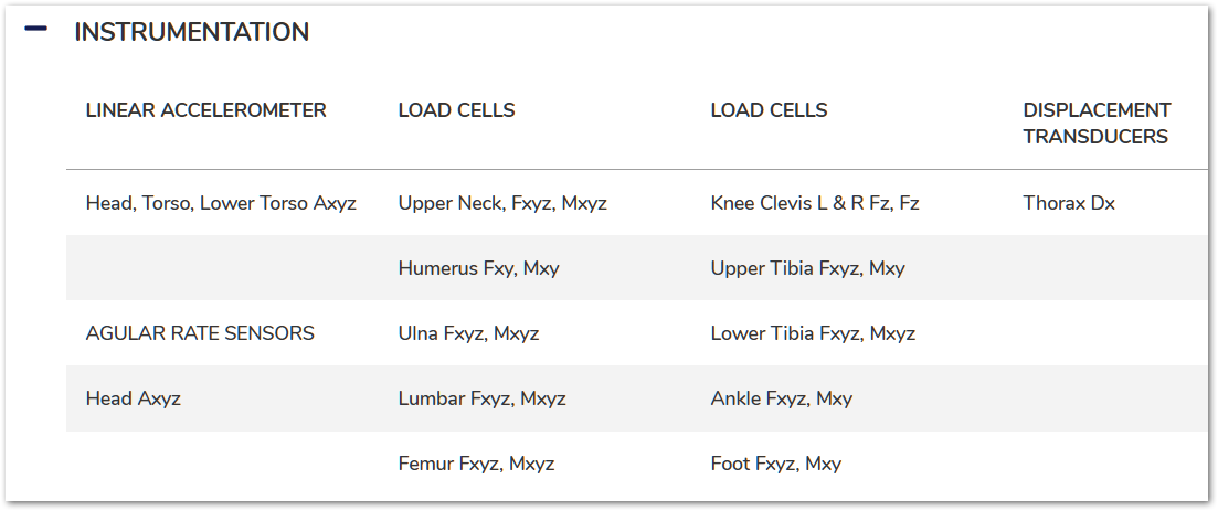

Instrumentation like this:
2025-12-16 19_28_14-Windows Input Experience.png (39.83 KiB) Viewed 29034 times
I guess MD will do fine here. All other parts of the channel codes are quite clear from the underlying H3 base design.
