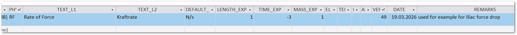

Agreement March 19th 2026: RF = Rate of Force will be taken.
Re: ILIAC Drop Force
Added to database 1.6.3p1 (2026-03-19):
2026-03-19_New_PD_RF - Rate of Force.png (11.6 KiB) Viewed 46540 times
