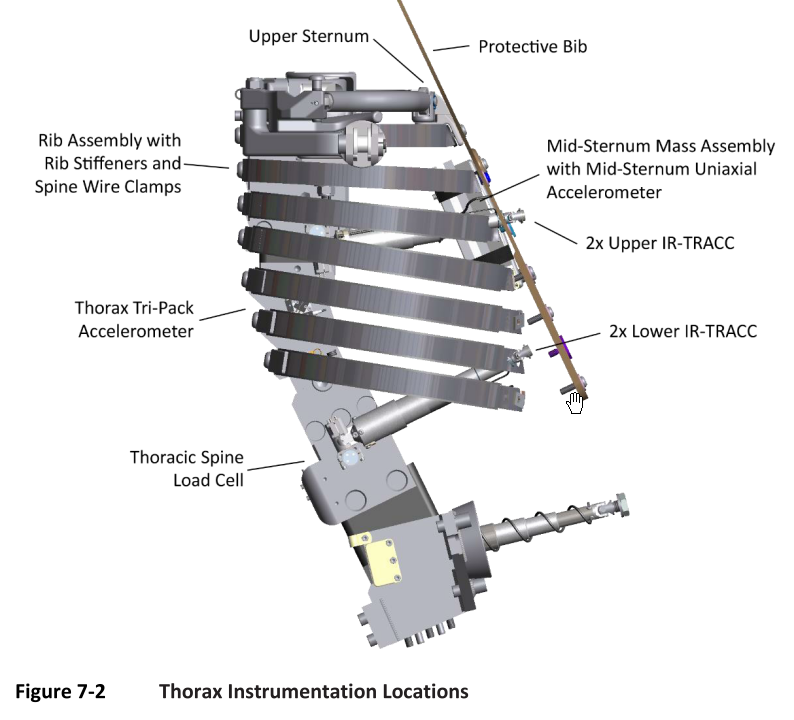

according to the outcome of the task force meeting, i have reworked the TH figures:
- splitted Calvicle IN/OU
- added THSP 01/12 AV X/Y/Z
- re-arranged standard and additional measurements
ISO-TH_20171213.pdf
(173.43 KiB) Downloaded 1807 times
Find also the current working list for standard/additional instrumentation:
2017_12_13_THOR_Standard_Additional.xlsx
(21.62 KiB) Downloaded 1803 times
also I changed some details:
- added a 7th rib to the figure
- repositioned location for chest deflection on 3rd, 6th rib
The next step will be to prepare additional slides for the T3 variant "THOR Europe".
So stay tuned ;-)
