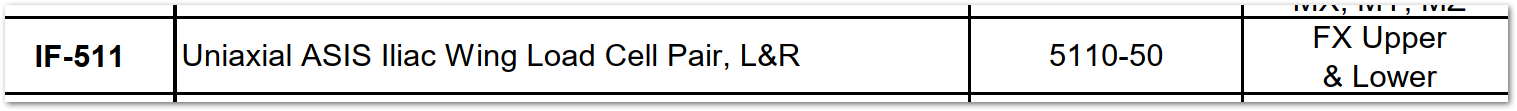

SUMA FOX UP/LO (each side) -> DB
2026-05: according to current figure and instrumentation reference:
ILAC FOX, MOY (each side)
2026-05-28 12_55_29-.png (4.39 KiB) Viewed 12293 times
and
