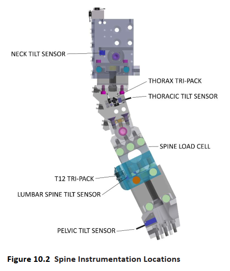

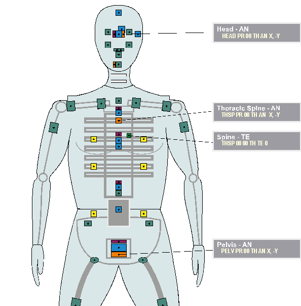

currently we have defined the following tilt sensors for the positioning of the THOR dummy:
??HEADPR00THAN X/Y ?
??THSPPR00THAN X/Y ?
??THSP12PRTHAN X/Y ?
??PELVPR00THAN X/Y ?
But there is one more tilt sensor needed for the THOR at the Neck Pitch change:
TH Tilt Sensors.png (5.28 KiB) Viewed 48827 times
TH Neck Pitch Change Tilt Sensor.png (49.62 KiB) Viewed 48827 times
So I would propose to add:
??NECKPR00THAN X/Y ?
We also need to add in the current figure of the TH the THSPPR12 sensor.

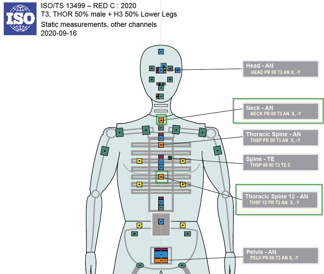

desision on the todays Task Force Meeting:
add the missing positioning sensor as:
The TH/T3 figure will be prepared with all 5 tilt sensors and
as a first variant for the new locations/naming of the temperature sensors as in ISO 27957 for the next meeting.
2020-04-01 12_51_30-Window.png (126.29 KiB) Viewed 48820 times
see: viewtopic.php?f=38&t=589
Posts: 483
Re: Tilt Sensor for TH, T3 NECKUP
I have implemented the new locations for the tilt sensors in the figures:
According to the manual the locations are:
The new locations of the temperature sensors are not included as we decided to await the complete rework of all figures after the new release 1.6.2.
