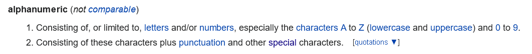

In the specification of the ISO MME (V1.x) several descriptor values are given the attribute:
"alphanumeric"
Indeed this is not very specific. You will find (https://en.wiktionary.org/wiki/alphanumeric):
2023-10-17 12_20_44-alphanumeric - Wiktionary, the free dictionary – Mozilla Firefox.png
2023-10-17 12_20_44-alphanumeric - Wiktionary, the free dictionary – Mozilla Firefox.png (13.24 KiB) Viewed 58757 times

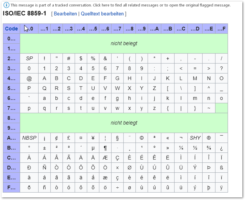

Based on the encoding for the descriptor files of ISO 8859-1 this will enable a wide range of characters that might be used.
2023-10-17 12_29_21 ISO8859-1_encoding.png (145.98 KiB) Viewed 58757 times
Indeed some characters that are difficult to distinguish should be ommited.
