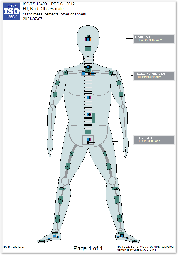

I just realized that in the BioRID figure the temperature sensor code is missing:
2026-05-27 11_31_13-BR_Static.png (43.97 KiB) Viewed 16402 times
Code might be THSP0000BRTE0.
Location should be best taken from:
ISO/DTR 27957 " Road vehicles — Temperature measurement in anthropomorphic test devices — Definition of the temperature sensor locations"
Is there a need to specify LE or RI in the code?
Other dummies will not reflect the side.
