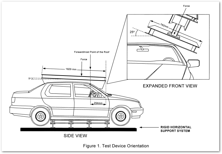

there is no main location for the piston used for roof tests (FMVSS 216a) or for door intrusion tests (FMVSS 214). Using LOMA is more for a not movable device (in my head). Can we find and introduce a better solution? (We used PLAT for plate). Piston perhaps describes it better?
Thanks, Gerd
Posts: 483
Re: main location roof test door intrusion test
Dear Gerd,
I provide here some image to visualize the test conditions in the § 571.216a procedure:

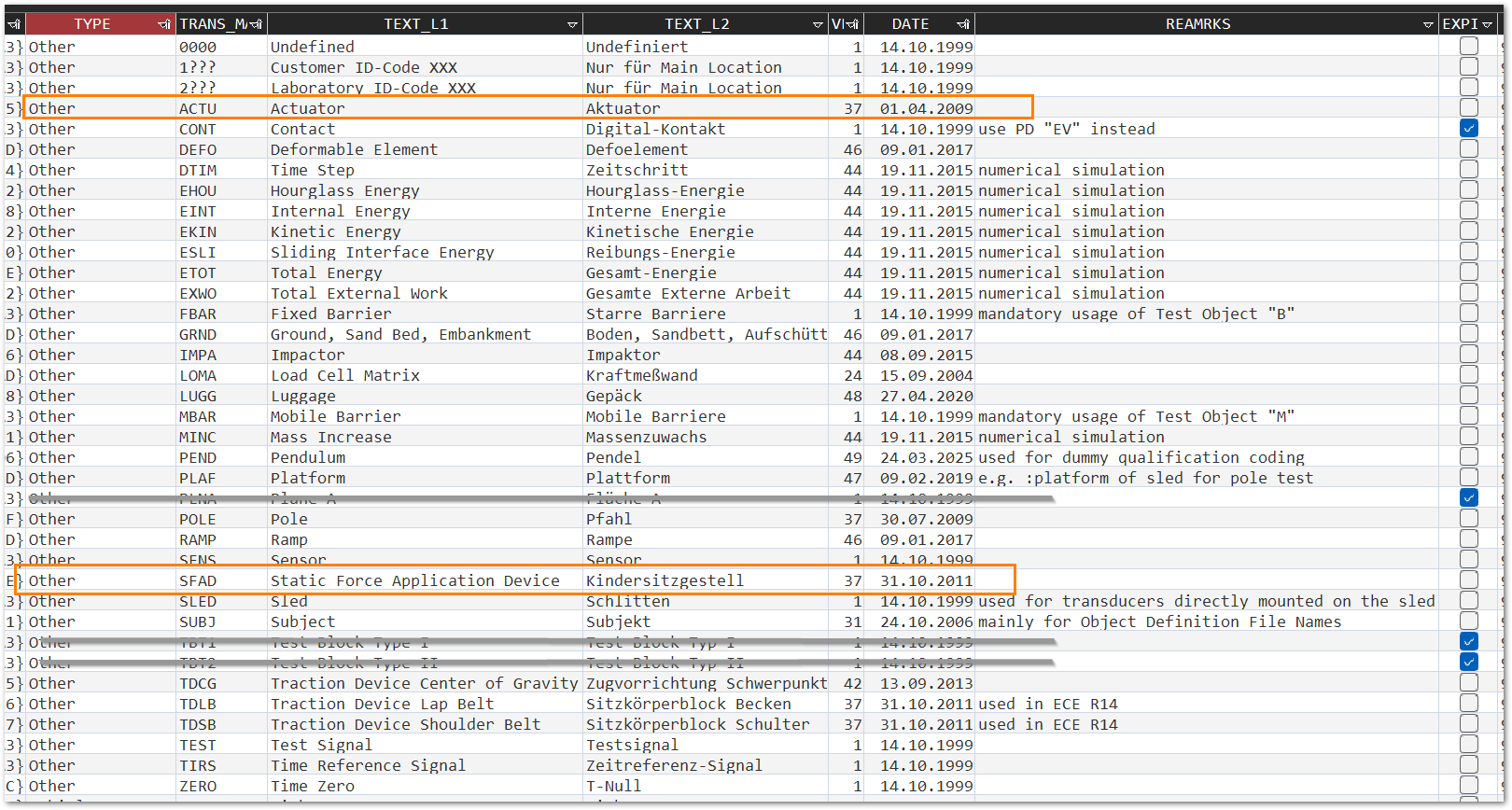

In the database the following Main Locations are available:

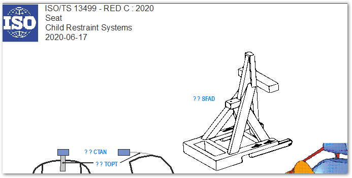

SFAD sounds similar, but is intended for a very specific CRS test rig:
May ACTU (Actuator) could be used here?
Otherwise we should go for a new main Location.
I would prefer to have a general code to be able to use it also for other/similar test devices.

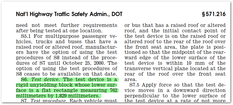

As the relevant contact interface is a plate the PLAT is a good option.
The existing IMPA sound like a dynamic test device?
