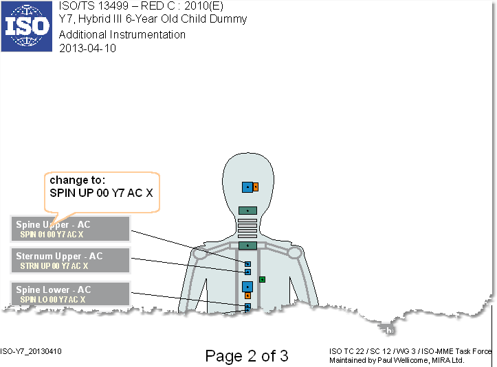

Dear coleagues,
Christian Brockhusen unveiled that there is a mismatch in the Y7 (H3 6Year) dummy figure and the database.
In the original figure Y7_1_11.wmf we have coded the measurement on the upper Spine as
??SPINUP00Y7ACX?.
This corresponds to the naming of the second height level: ??SPINLO00Y7ACX?.
Also there are two additional measurements on the Sternum with the UP and LO
coding approoach: ??STRNUP00Y7ACX?, ??STRNLO00Y7ACX?.
These measurements will also be used to generate relative deflection from acceleration.
Now, with the reneval of the Y7 figure to the 3 page standard format we might have had
a little copy and paste issue and now the coding is: ??SPIN0100Y7ACX?
I reviewed also the 2015 approach from Peter: "20150415_Dummy_Status_DBvsFigures.xls":
Also here we have used the SPINUP-variant.
This is also the current code in the database.
After this long text my finally proposal is to switch back to the SPINUP variant in the Y7 figure page 2.
