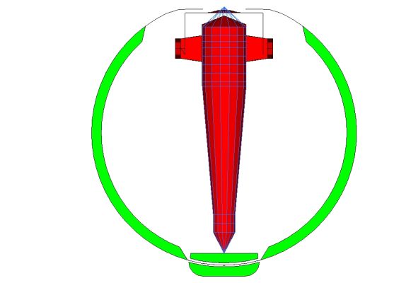

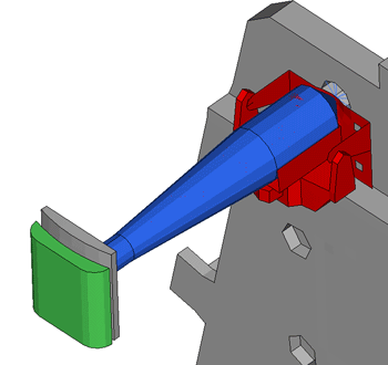

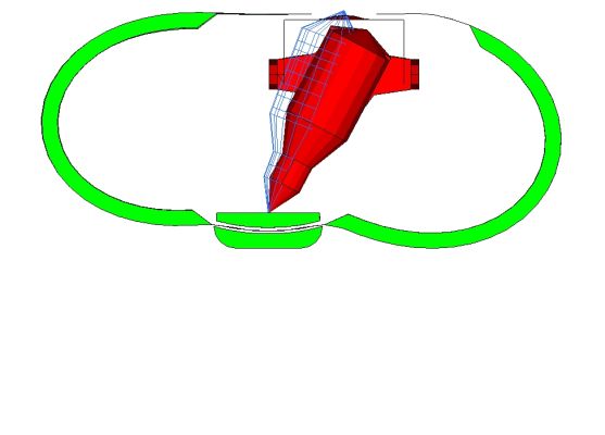

There are two systems available to measure the rib deflection of the WS50% - IR-TRACC 1D (current solution) and IR-TRACC 2D (probably future solution). The 1D system measures the deflection between rib bracket and spine box. The 2D system measures the deflection between rib bracket and a moving point in front of the spine box, and the sensor’s rotation about the vertical axis. Both systems are measuring only the same deflection under pure lateral rib deflection (rare condition) --> see attachement
Therefore, it would be helpful to use different ISO codes for both systems to distinguish between measurements of the 1D and the 2D system.
Proposal:
1D system: current code *DSY*; correct code would be *DSR*, but should not be changed because the system could become obsolete
2D system: proposal: *DS0* (*DSX*, *DSY*, *DSZ*, and *DSR* could be calculated if two additional angles are available: rotation of the sensor about z and x)
Christian Gehre
Proposal:
Christian Gehre
