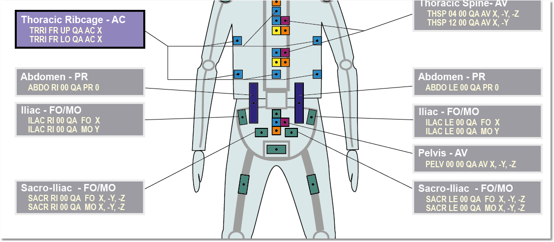

In the ISO MME Task force meeting (2017-04-04) we have decided to add the requested codes to page 2 of the QA figure.
Also we desided to move the channels from the Sacrum-Iliac measurements from the first page to the second page.
I have prepared an update for the figure that also uses new (hopefully realistic) positions of the load cells:
Any response will be welcome as always.

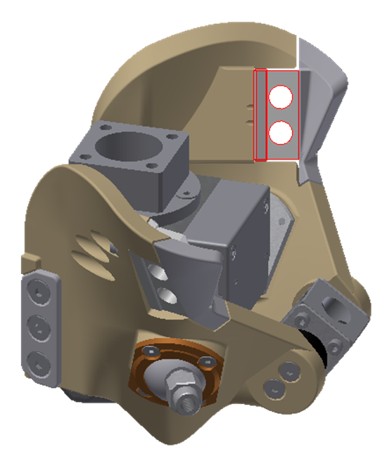

with the permission of Kees, I can provide the pictures of the ILAC LC integration here:
Q6 pelvis integration of ILAC LC
Q10 pelvis integration of ILAC LC
With the information given in the former post I will add the ILAC Codes also to Q6 now....
Re: QA (Q10) Iliac Load Cell Codes
here is the corresponding figure.
ISO-QA_20170405.pdf
first pdf version
