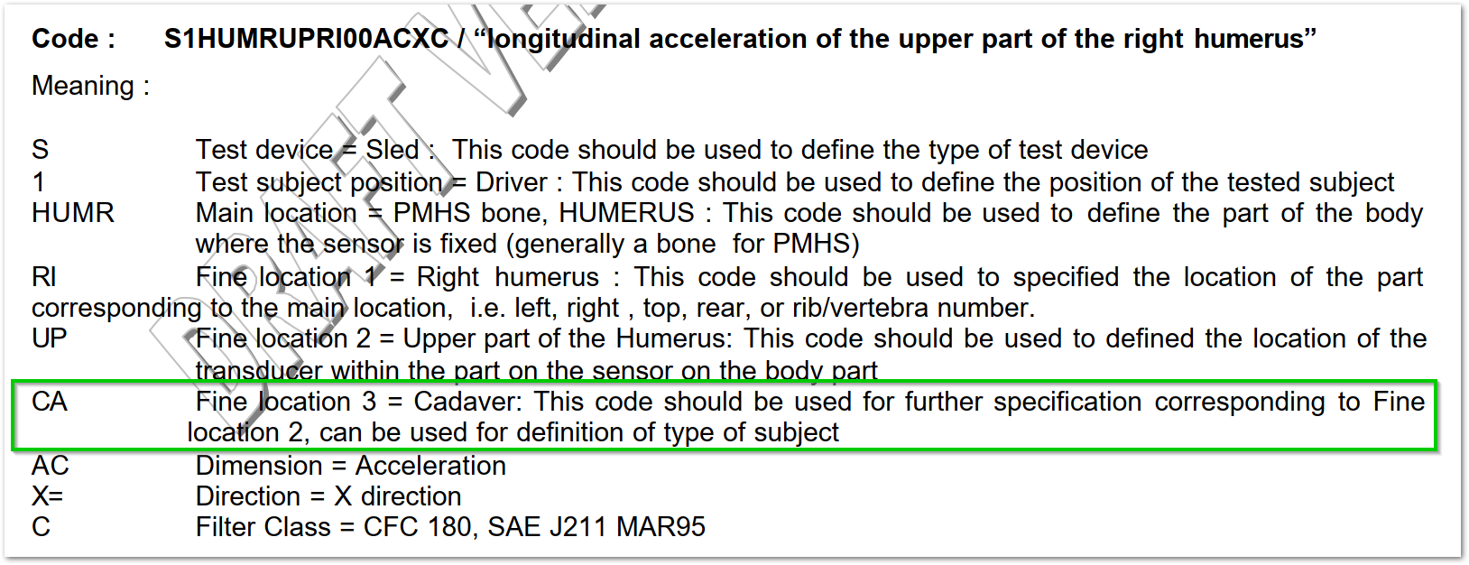

implemented from the 2012 proposal and the coding would be available: For the other forum member I have here a snapshot from the draft version provided in the Humos2 Project in 2012: What stands "CD for in the NHTSA context?

It is a good idea to harmonize. In the current database there is nothing
