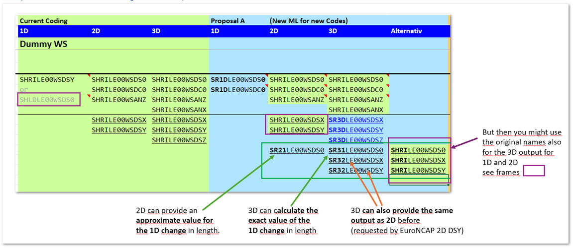

Re: Coding for 3D-MTRAC to 1D/2D calculated channels
Dear All,
based on the new coding concept introduced by PDB for the WS (1D,2D,3D) we have prepared
an overview for the first coding approach we have intend to use and the new one.
Find here the latest document as base for the discussion on the next ISO MME Meeting (23rd of March 2026):
ISOCodes_1D2D3D_Options_091_2026_02_26.xlsx
(23.57 KiB) Downloaded 1379 times
Any comments and ideas are welcome for the descission on the final coding.
based on the discussion at the AK3 2026-03-25 I have updated the table and added a "Proposal C".
This will correspond to "Proposal B" for new codes, but also use the approach to keep existing codes
for measurements (DC0,ANZ,ANX).
ISOCodes_1D2D3D_Options_092_2026_03_25.xlsx
(27.62 KiB) Downloaded 2522 times
one more image for explanation:
3D MTRAC_Table_Codes.png (224.51 KiB) Viewed 2053675 times

my favorite proposal is proposal C. So we can keep the existing codes for measurement and clarify the codes for calculation. But there are still two ways to calculate from 2D to 1D (UN-ECE, E-NCAP). What's about that?
